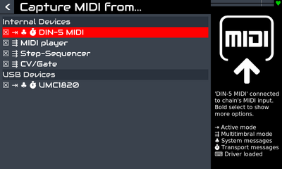

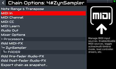

===MIDI input===
[[File:Chain options2.png|400px|right]]
[[File:Capture MIDI.png|400px|right]]
Each chain receive MIDI input from selected devices (keyboards and other MIDI controllers). You can configure the MIDI input devices from the chain's option menu. Use short-push for selecting the devices and bold-push for changing the input mode. All input devices are selected by default when creating a new chain.
Each input device can work in 3 different modes:
* '''ACTI:''' only the active chain receives all MIDI input from the device and all MIDI events are translated to the active chain's MIDI channel. It's the default mode.
* '''OMNI:''' each chain receives all MIDI input from the device and all MIDI events are translated to each chain's MIDI channel.
* '''MULTI:''' each chain receives MIDI from the input device in the configured MIDI channel. No MIDI channel translation is done.
When using ACTI mode you don't need to worry about the MIDI channel your keyboard/controller is using. You change the instrument you play by changing the active chain in your zynthian. You can change the active chain by simply rotating the select knob (#4) in the Mixer view or using the the left/right arrows.
In the other hand, MULTI mode allows receiving and managing separately every MIDI channel. Each MIDI controller will drive the chains assigned to the controller's MIDI channel. If you are using a MIDI controller that can sequence multiple tracks (Beatstep Pro, Keystep Pro, Novation Circuit etc.) then you will generally want to use this mode.
In the other hand, '''multitimbral mode''' allows receiving and managing separately every MIDI channel. Each external MIDI controller will drive the chain that is assigned to that controller's MIDI channel, e.g. a chain assigned to MIDI channel 1 will listen for MIDI messages on MIDI channel 1 only<sup>*</sup>. If you are using a midi controller that can sequence multiple tracks (Beatstep Pro, Keystep Pro, Novation Circuit etc.) then you will generally want to use this setting.
Finally, OMNI mode allows one or several chains to receive all MIDI input from your device translated to chain's MIDI channel. This can be useful for some use-cases. Be warned that this mode will be dropped in the near future so you should avoid it.
(*) MIDI Continuous Controllers are handled differently. See section on [[#MIDI-learning_.2F_binding|MIDI Learning & binding]].
Note that MIDI CC (Continuous Controllers) events are handled differently and they are not routed to chains. See section on [[#MIDI-learning_.2F_binding|MIDI Learning & binding]].
<br clear=all>

2.2 MIDI input
  • ACTI: only the active chain receives all MIDI input from the device and all MIDI events are translated to the active chain's MIDI channel. It's the default mode.
  • OMNI: each chain receives all MIDI input from the device and all MIDI events are translated to each chain's MIDI channel.
  • MULTI: each chain receives MIDI from the input device in the configured MIDI channel. No MIDI channel translation is done.
