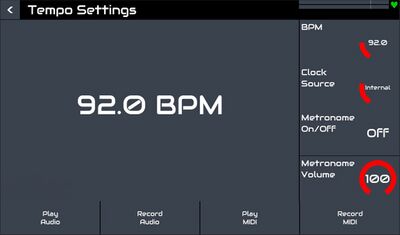

[[File:Tempo page.jpg|400px|right]]
On the tempo settings page you'll find options relating to time and some record/playback functions. The options are:
* Tempo adjustment (BPM)
* Metronome toggle and
* Metronome volume
* Audio record/playback and
* Midi record/playback
You can also choose the source of the clock that drives some zynthian modules, such as the sequencer. This may be:
{| class="wikitable" style="font-weight:bold;"
|- style="font-weight:normal;"
! colspan="2" | Clock Source Options
| Internal
| style="font-weight:normal;" | The sequencer acts as the clock, so clock is running when sequence is running and BPM parameter controls clock rate.
| Internal send
| style="font-weight:normal;" | Same as Internal but MIDI clock is sent to MIDI outputs, not just internal modules.
| MIDI
| style="font-weight:normal;" | Use external MIDI clock to drive internal modules, such as sequencer.
| Analogue
| style="font-weight:normal;" | Use a GPI pin as a clock signal (similar to DIN Clock) for internal modules.

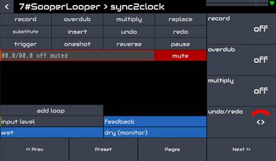

[[File:SooperLooper v5 1.jpg|400px|frameless|right]]
'''ALT mode'''
'''ALT mode'''

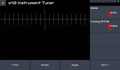

[[File:X42 Instrument Tuner.jpg|400px|frameless|right]]
The x42 Instrument Tuner with a native GUI for Zynthian and is available in the ''Audio Chain/Audio Effect/Analyzer''.

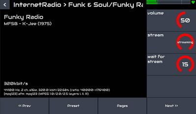

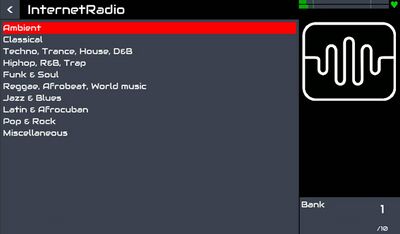

Zynthian has internet streaming radio with a selection of channels available as a chain from the ''Audio Generator/Other'' category.
[[File:Internet Radio 1.jpg|400px|frameless|right]]
[[File:Internet Radio 2.jpg|400px|frameless|right]]

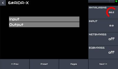

[[File:AIDA-X 1.jpg|400px|frameless|right]]
A guitar amp simulator using machine learning. Parameters are available across 5 pages. Accessible via ''Audio + Midi Chain/Audio Effect/Simulation''. See the [[AIDA-X]] page for some links to different model and impulse response files.

8.4 Tempo Settings
  • Tempo adjustment (BPM)
  • Metronome toggle and
  • Metronome volume
  • Audio record/playback and
  • Midi record/playback
Internal The sequencer acts as the clock, so clock is running when sequence is running and BPM parameter controls clock rate.
Internal send Same as Internal but MIDI clock is sent to MIDI outputs, not just internal modules.
MIDI Use external MIDI clock to drive internal modules, such as sequencer.
Analogue Use a GPI pin as a clock signal (similar to DIN Clock) for internal modules.

9.2 Sooperlooper
ALT mode
Redefines the short-push functionality of transport, arrows and F1-F4 buttons:
  • REC
    • on empty loop: toggles recording in the selected loop
    • on busy loop: toggles overdubbing in the selected loop
  • PLAY toggles mute the selected loop
  • STOP toggles multiplying the selected loop
  • F1 toggles replacing in the selected loop
  • F2 toggles substituting in the selected loop
  • F3 toggles inserting in the selected loop
  • F4 adds a new empty loop
  • LEFT undo the last operation in the selected loop
  • RIGHT redo the last operation in the selected loop
  • UP/DOWN changes the selected loop
9.3 Tuner
The x42 Instrument Tuner with a native GUI for Zynthian and is available in the Audio Chain/Audio Effect/Analyzer.

9.5 Internet Radio
Zynthian has internet streaming radio with a selection of channels available as a chain from the Audio Generator/Other category.
9.6 AidaX
A guitar amp simulator using machine learning. Parameters are available across 5 pages. Accessible via Audio + Midi Chain/Audio Effect/Simulation. See the AIDA-X page for some links to different model and impulse response files.
