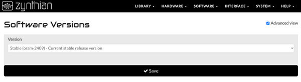

==Software Version==
[[File:Update available icon.png|Software update available icon|right]]
By default, zynthian runs the stable release, oram-2409. Any stable point releases are advertised in the user interfaces with the green circle-arrow icon showing in the top right.
Updates may be applied by selecting ''Update Software'' in the admin menu or selecting the ''SOFTWARE->Update'' option in webconf, then pressing the ''Update Software'' button.
<br clear=all>

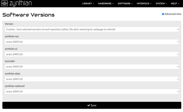

[[File:Software version - oram stable.png|Webconf software version with oram stable selected|600px|right]]
There are four options for selecting which version of zynthian to run. The selection is made in webconf's ''SOFTWARE->Version'' page:
===Stable (oram-2506)===
Selecting this version will configure zynthian to run the most stable version of the software. Updates are infrequent and extensively tested. This is the default version and is recommended for production use. Only ''point releases''  appear in this software channel. A point release is a stable version, e.g. oram-24090.1 is the firsts stable update after the release of oram-2409.

===Custom===
[[File:Software version - custom.png|Webconf software version with custom selected|600px|right]]
Selecting the ''Custom'' option will, after a few seconds, allow individual selection of each software repository. This provides granular control of the software configuration. Each list contains the stable version, stable point releases, testing version and all development branches. There are two main use cases for selecting custom:
* Freezing the software at a specific point release - selecting a point release for each of the repositories will freeze the software at that version and no updates will be advertised in the user interface.
* Testing bleeding edge development - a new feature may be developed in a specific development branch which may need to be selected to allow testing. It is highly recommended to avoid using this option unless you have a clear understanding of why it may be necessary, e.g. instructed to do so by a core developer.
After selecting this option, select 'Save' and then 'Software Update' to apply changes.

11 Software Version
By default, zynthian runs the stable release, oram-2409. Any stable point releases are advertised in the user interfaces with the green circle-arrow icon showing in the top right. Updates may be applied by selecting Update Software in the admin menu or selecting the SOFTWARE->Update option in webconf, then pressing the Update Software button.
There are four options for selecting which version of zynthian to run. The selection is made in webconf's SOFTWARE->Version page:
11.1 Stable (oram-2506)
Selecting this version will configure zynthian to run the most stable version of the software. Updates are infrequent and extensively tested. This is the default version and is recommended for production use. Only point releases appear in this software channel. A point release is a stable version, e.g. oram-24090.1 is the firsts stable update after the release of oram-2409.
After selecting this option, select 'Software Update' to apply changes.

11.4 Custom
Selecting the Custom option will, after a few seconds, allow individual selection of each software repository. This provides granular control of the software configuration. Each list contains the stable version, stable point releases, testing version and all development branches. There are two main use cases for selecting custom:
  • Freezing the software at a specific point release - selecting a point release for each of the repositories will freeze the software at that version and no updates will be advertised in the user interface.
  • Testing bleeding edge development - a new feature may be developed in a specific development branch which may need to be selected to allow testing. It is highly recommended to avoid using this option unless you have a clear understanding of why it may be necessary, e.g. instructed to do so by a core developer.
