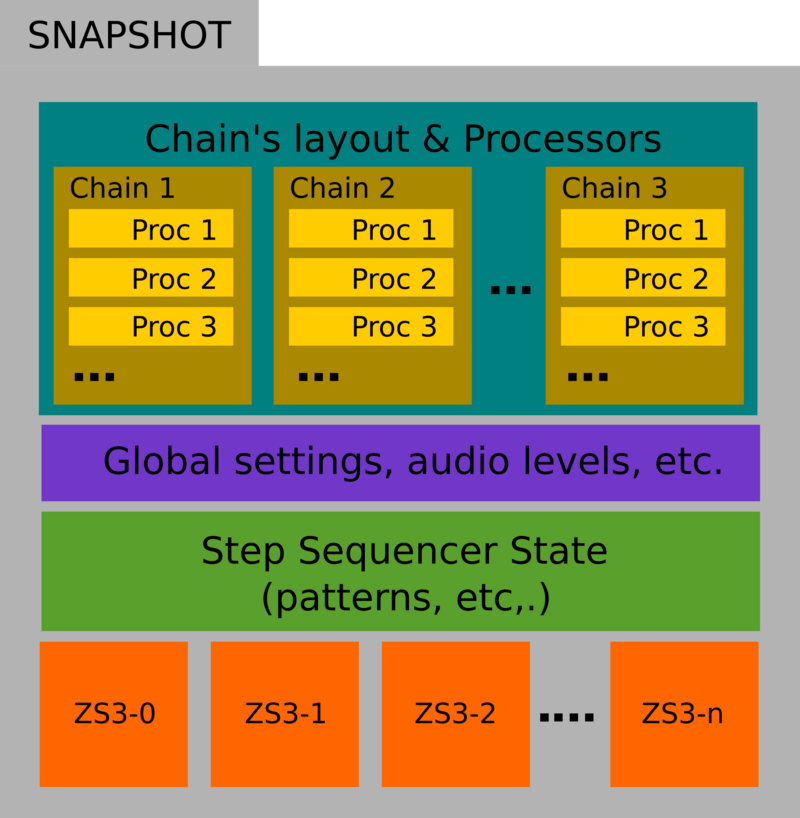

2.4 Snapshots
A snapshot is the captured state of zynthian at the time of saving the snapshot. Snapshots are saved in a JSON file with .zss extension and can be loaded at any time, which effectively restores the state of the zynthian device when the snapshot was saved. Snapshots include:
  • chains layout: configuration of each chain including its processors and how they are arranged and connected
  • audio levels: (optional) physical audio interface settings
  • sequencer: patterns & sequences
  • MIDI settings: global MIDI settings, USB MIDI port names, etc.!!
  • multitrack record settings: mixer strips armed for multitrack recording
  • UI state: some user interface configuration relevant to the snapshot (most UI is configured globally)
  • sub-snapshots (ZS3s): most other configuration (see ZS3)
