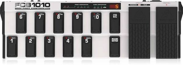

This drivers has been originally designed for the Behringer FCB1010, but it can be used with any MIDI controller sending the right MIDI CC as described in the table below.
Each pedal of the FCB1010 is mapped to CC and SooperLooper as described in the next table. Note that you MUST configure your FCB1010 to send triggers with the specified CC numbers. It won't work with FCB's factory assignments, as they are "frankly daft". Of course, you could configure any other MIDI controller to send the same CC numbers and use it instead, so to some extend, this driver is not exclusive for the FCB1010, although it's been designed with it in mind.

1.1 Configure the Behringer FCB1010
Here’s how to configure the FCB1010, assuming starting from FCB1010’s factory default:
* Select the pedal you want to program (e.g., 1).
* Long press the Down button (2-3 seconds) to put the pedal in programming mode.
* Short press the Up button.
* By default, “1” is lit, indicating that the pedal is sending a program change. We need it to send a control change (“6”).
* Long press “1” (program change) until it is unlit.
* Long press “6” (control change) until it is lit.
* Short press “6” to program the control change. “6” will start blinking.
* Press Up.
* Enter the CC number you want to set for the pedal. For example, in this ctrldev, I map Pedal 1 to CC 15. Numbers are entered by clicking the pedal numbers in order (e.g., “1” and “5”). The numbers will appear in the LED screen.
* Press Up.
* Enter the value you want to send for the CC. I enter “127” for every control (e.g., “1”, “2”, “7”).
* Press Up. “6” stops blinking and is solidly lit. The pedal is now programmed.
* Long press Down to exit programming mode.
* Repeat 1-13 for each pedal (e.g., Pedal 2 = CC 16, etc.).
