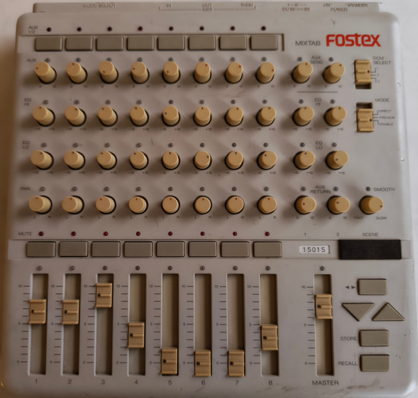

This driver uses MIDI input and output to communicate with a Fostex Mixtab control surface. The Mixtab was released in 1992 as a hardware controller for the Fostex DCM100 1U rack mounted 8-channel stereo mixer. It provides controls for each of that mixer's parameters, the ability to switch between up to 3 mixer units and offers absolute and pick-up modes of operation. This driver maps the hardware controls to relevant parameters in zynthian (mostly zynmixer).
Each fader strip controls the corresponding audio channel (audio, synth, etc.) in the same order as displayed in zynthian. The DCM SELECT switch moves the control between the first, second and third groups of 8 chains, allowing control of up to 24 chains. The last fader controls the main mixbus.
Each channel strip has the following controls:
  • AUX
  • EQ HI
  • EQ LO
  • PAN
  • MUTE
  • FADER
Fader and pan control the level and pan/balance of each chain. The Mute button sends volume 0, not seperate mute signal.
ZS3 is saved by double pressing the STORE button within 1.5s, but the display must stop flashing before the second press.
The SMOOTH control adjusts tempo.
The AUX EQ act as encoders 1..4.
Other controls act as learnable controllers. (Note AUX1 & AUX2 send the same CC, each over the range 0..63 and 63..127 respectively.)
