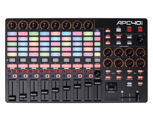

1 Akai APC40 MK2
APC40mkII
This device is well supported and one of the benchmark drivers for Zynthian with Zynpad and Zynmixer functionality.
