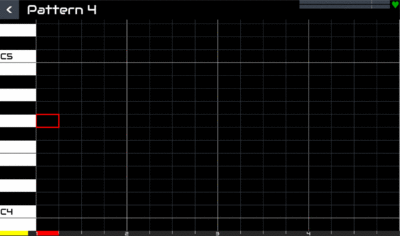

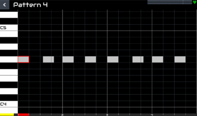

Note Step Adjustment
Velocity Adjustment
Add Offsets
All Velocity Adjustment
Each note may be adjusted to have different duration, velocity, etc. To adjust a note's parameters, bold SELECT to show the parameter editor. Use encoder 4 (or onscreen buttons if enabled) to select the parameter to adjust. The options are:
  • Duration: Quantity of steps at 0.1 resolution. Duration of each note is shown by the length of the event in the grid.
  • Velocity: MIDI velocity 0..127. Current velocity is shown by yellow line at bottom left of screen and the opacity of each note. The brighter the cell, the louder the note.
  • Offset: Note position from start of step 0..100%. Position of each note is shown in the grid.
  • Stutter count: Quantity of stutter repeats.
  • Stutter duration: Length of stutter in ticks.
  • Play chance: Percentage likelihood that the note will trigger.
Use encoder 3 to coarse adjust the selected parameter and encoder 2 to fine adjust. Bold SELECT to adjust all notes in the pattern. Navigate BACK to close the parameter editor.
