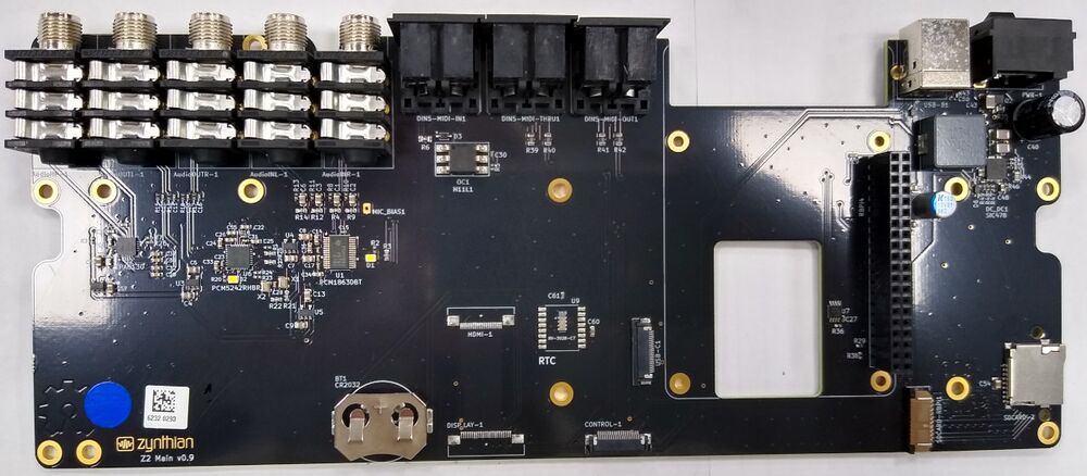

WARNING!!
If your main board or control board has a round blue sticker, please, pay attention to the specific instructions you will find along this tutorial. They will be displayed in blue warning boxes like this.

If your main board is labeled as v.0.9. we have added a round blue sticker on it. In this version, the USB-C FPC connector has bottom contacts and you must insert the ribbon cable with the metal contacts side FACING DOWN.

WARNING!!
If your main board is labeled as v.0.9. we have added a round blue sticker on it. In this version, the control-1 FPC connector has bottom contacts and you must insert the ribbon cable with the metal contacts side FACING DOWN.

Note the absence of the chips addressed in 20 & 21 (2 x MCP23017). This means your control board is not being detected and most probably is not well connected.
Anyway i would like to offer a solution for those having issues with this. Indeed, the solution is simple and it has been already explained by @simmeah in the forum:
Use a cutter or scalpel to cut the 2 tiny plastic bumps that cause the issue.
The bumps are really tiny and you probably need good eyes or magnifying glasses. The tool must be well sharpened, so the plastic bumps can be cut will minimal force. Be extremely careful to not worsen things by breaking the FFC's latch.
You must repeat the operation for all FFC connectors used by V5. They are:
  • Main Board
    • CONTROL-1
    • USB-C1
    • SDCARD-RBPi1
