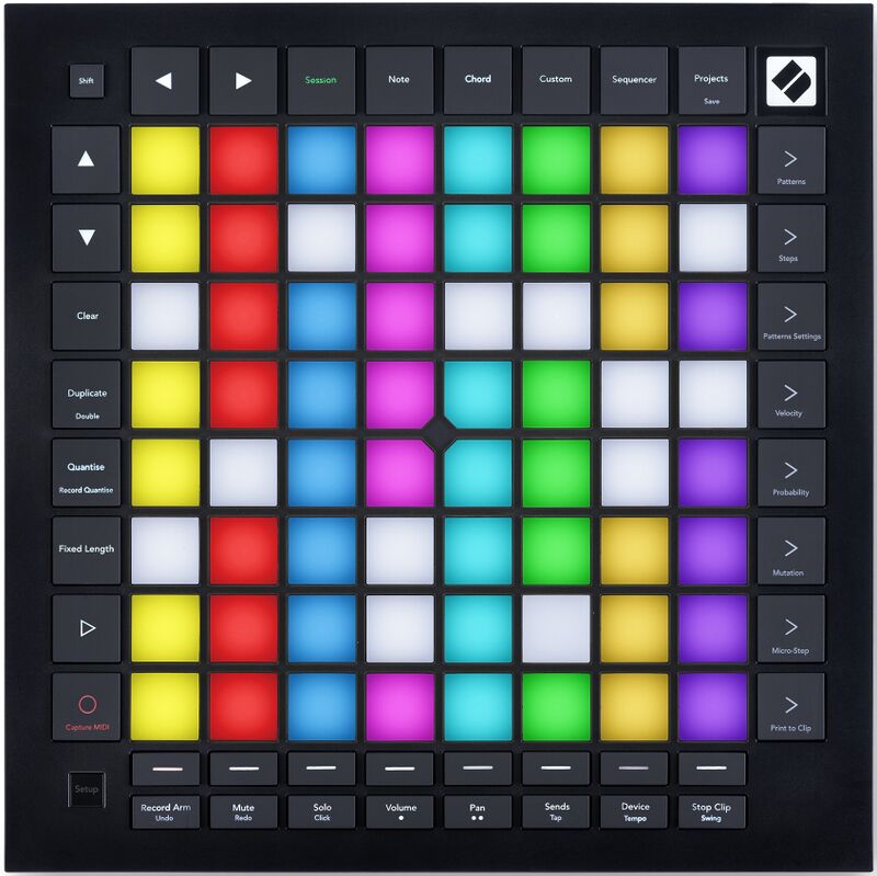

9 Novation LAUNCHPAD PRO MK3
9.1 ZynPad driver
It works much like the Launchpad Mini MK3.
